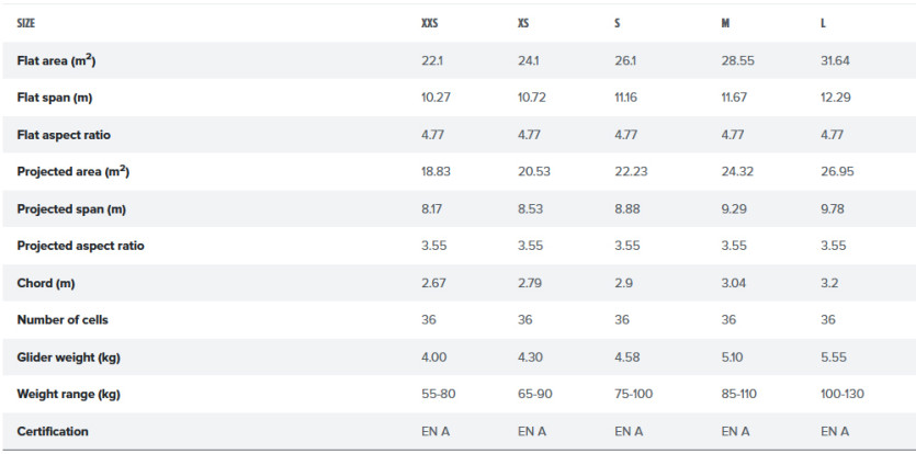

TECHNICAL SPECIFICATIONS

Canopy cloth
Upper surface leading edge: Dominico Dokdo 30D (WR) / Myungjin MJ40 MF
Upper surface: Myungjin MJ32 MF
Lower surface: Porcher Skytex Easyfly 40
Lines
Upper: GIN TGL 80 (Aramid)
Middle: GIN TGL 125 (Aramid), Liros DSL 70, Liros PPSL 120
Main: LIROS PPSL 120 / 160 / 200
